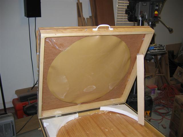

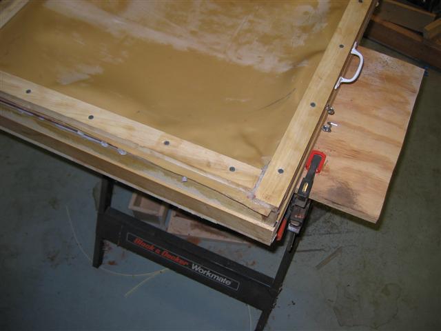

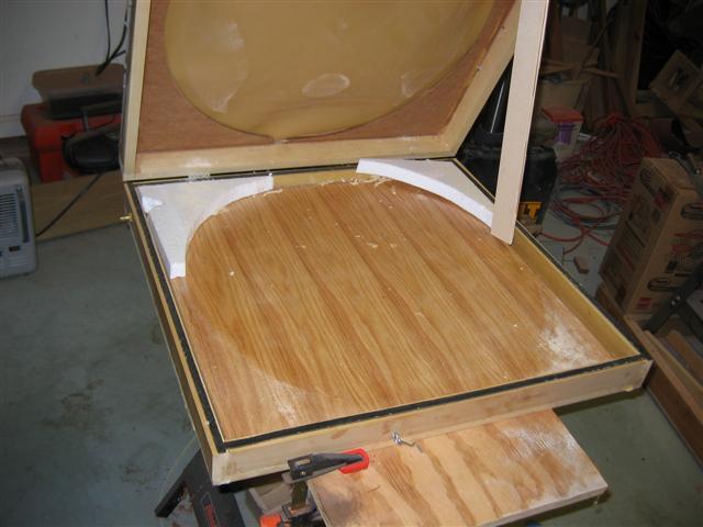

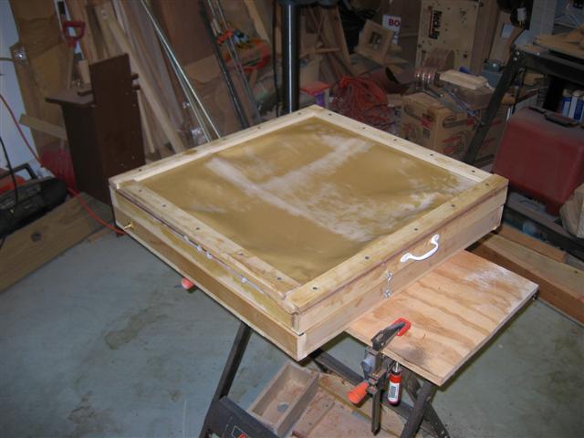

PostPosted: Wed Aug 02, 2006 10:34 am
Posts: 449
Here's what I made. Basically just a plywood box large enough to hold my sanding bowl with lots of shellac and caulk to keep it airtight. I've used it on 3 guitars and the process itself works very well. The only problem is that on the last guitar the pressure caved in one corner of the mdf ring that circles the sanding bowl. (I thought if I didn't have the ring the rubber would either distort the pieces being clamped or tear as it compressed all the way down to the bottom of the box.) It's still airtight, but could probably use a redesign. I'm going to cut ply fillers to replace the styrofoam inserts. That is unless someone has an idea for a better jig.
